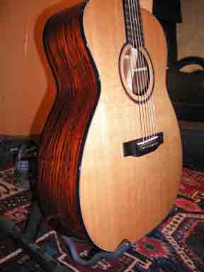

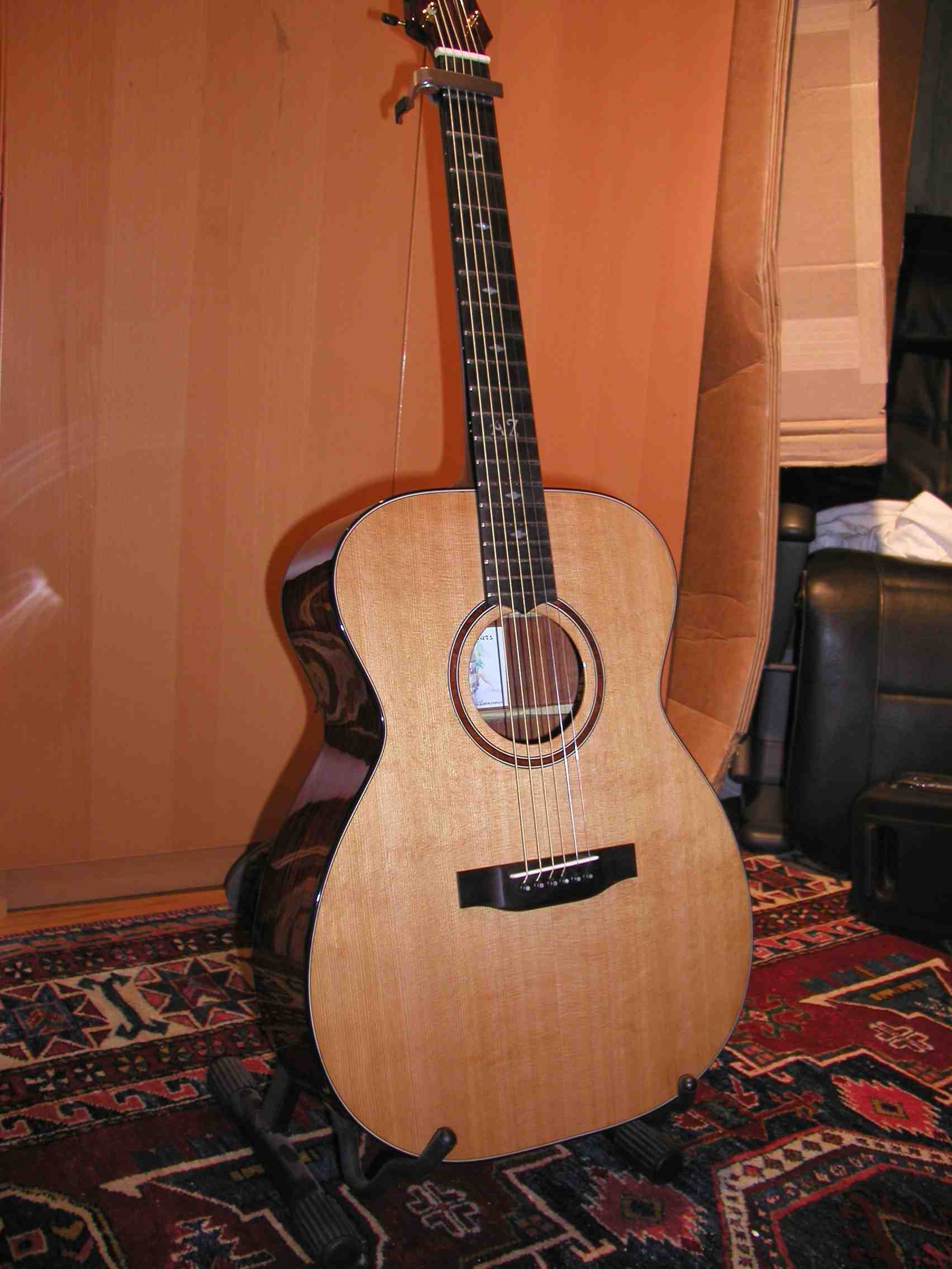

Here is my first guitar from scratch.
000 14 fret
Cedar Top
Cocobolo Back and Sides
Thanks for all Your Help
Andy

az001 is cosmetically a winner! how well does she sing?
PostPosted: Sat Sep 03, 2005 8:52 pm
Posts: 720
Looks fantastic Andy!,very tidy and elegant
congratulations

Congrats Andy! Beautiful, absolutely beautiful.

Nice! How about a pic of the back?
PostPosted: Sat Sep 03, 2005 11:50 pm
Very nice Andy,What kind of finish did you use?
PostPosted: Sat Sep 03, 2005 11:57 pm
Fantastic! I;d love to see about 10 more pics! End graph, close up of the rosette, the headstock! You know what we want
PostPosted: Sat Sep 03, 2005 11:58 pm
Great job Andy! I agree with Lance, more pics!!!

Looks really nice Andy. I love the silking in the top and bet it is even prettier in person.

Thanks for the kind words
I will have to take some more picts.
It sound fine except the B string. I have another thread on this.
It seems to have a slightly muted and buzz on the B string even though the
action is correct and the nut slot seems to be the correct depth.
It is driving me mad.
Andy
The finish is urethane (Tony F did it for me)

Andy,
I'm looking at the photo of your guitar and it is capoed at the first fret. This is a good way to test the buzz problem with the b string. With the capo on at the first fret do you still have the buzz / muting ? If not it is most likely due to a problem with the nut slot. If you still have the buzz, you can probably rule out the nut. Look to the string or the saddle / bridge. Very nice guitar by the way. And I agree, post more photos.Brazilwood38599.5289814815
